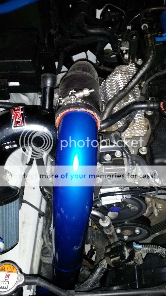

The nipple on the passenger side that runs to the hot side IC piping snapped off. I'll take some pics at lunch to show what I'm talking about. I'm thinking I can just run the BOV straight to the manifold and it should eliminate the boost leak. I hope.
#8 ·
The left side, closest to the IC piping. The nipple broke off and now under boost my bov didn't stay closed.

I tried putting electrical tape over the port that broke off. But didn't seem to have worked lol

It's connected to the top port. The nipple in question is on the back side of the solenoid closest to the pipe.
The leak is coming from my bov because it's not closing after it vents boost pressure.

Direct connection to intake manifold will fix your issue. Also, will save you money from having to buy the solenoid.

Well it fixed it. My bov stays closed under boost now. Just need to go back and make sure all the vacuum lines are tight. Heard a small vacuum leak. Thanks everyone for the responses and the help. :)
